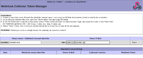

    WHDC requires the tenant-name+test and an e-mail address to identify the user and the notification channel in logs.
    This will create a registered tenant:

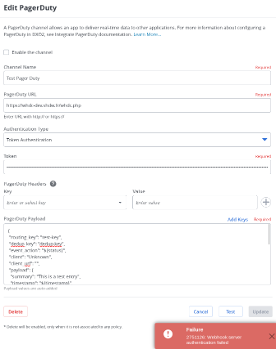

    Below is an example using a wrong token, which is noted in the configuration detail.
    Both the DX O2 configuration interface and the WebHook receiver site will show that the token is not correct. Showing the issues on both sides helps to ensure issues are not overlooked. Going further, teams can run a test which, in this example, displays a failure showing that the WebHook authentication failed.

    2. The log however shows the authentication token is incorrect.
    3. Also, the token field does not have the Bearer tag.

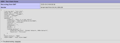

    We now have a successful WebHook submission and can view the payload detail.

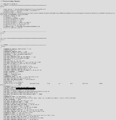

    If the operator needs additional details, selecting the “Headers” link on the lower left will show the full server-side content.
