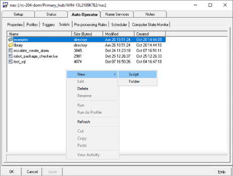

    To implement this in the Script tab of NAS/Auto Operator configuration (available only in Infrastructure Manager):
    1. Right-click and select New Script.

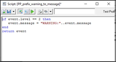

    2. Create the following LUA script:
      ESD_FY25_Academy-Blog.Power Up Your Alarms.Figure 2

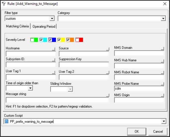

    3. Create the following Pre-Processing Profile:
      ESD_FY25_Academy-Blog.Power Up Your Alarms.Figure 3

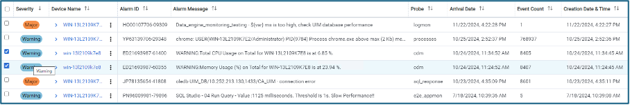

    As per the above profile, all Warning (level 2) alarms from the cdm probe will be prefixed with WARNING:
    ESD_FY25_Academy-Blog.Power Up Your Alarms.Figure 4

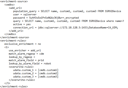

    Note: This probe is unique as it isn’t configured through its local .cfg file; instead, it relies on keys in NAS.cfg within specific sections:
    ESD_FY25_Academy-Blog.Power Up Your Alarms.Figure 5
    This configuration can only be achieved using the Raw configure in either Infrastructure Manager or Admin Console. Alternatively, you can edit the NAS.cfg directly on the Primary Hub, following with a restart to re-read the cfg file.
    Enrichment-source section
    Here, data sources and queries are configured along with connection strings to databases and credentials.
    Key
    Value
    Connection_url
    jdbc:sqlserver://172.x.x.x:1433;DatabaseName=CA_UIM;
    User
    Sqlserver_account
    Password
    password
    Population_query
    SELECT name, custom1, custom2, custom3 FROM SSRV2Device
    Query
    SELECT name, custom1, custom2, custom3 FROM SSRV2Device where name=?
    Active
    yes
    Connection_url—The data may not yet exist, therefore the implementor can point to a remote database or a newly created table in the DX UIM database.
    The Population Query caches data from this table; subsequently, a specific Query retrieves data for actual configuration items (CIs).
    The Query is used to select a single row of data, which is to be used to insert into the Alarm. The ‘?’ should be substituted with what as been defined in the lookup_by_alarm_field key.
    The password field is encrypted when the NAS restarts.
    Enrichment-rules section
    This section consolidates everything. The Use Enricher key specifies which database and query to use for data retrieval as defined in the Source section.
    Match_alarm_field indicates which field to select alarms on—typically Prid (probe).
    Match_alarm_regex defines regex patterns for selecting multiple values.
    Lookup_by_alarm_field specifies which field will have its values substituted in queries for enrichment.
    Key
    Value
    Use_enricher
    Add_url
    Match_alarm_regexp
    cdm
    Lookup_by_regexp
    Match_alarm_field
    Prid
    udata.source
    Overwrite-rules
             udata.custom1
    [cmdb.custom1]
             udata.custom2
    [cmdb.custom2]
             udata.custom3
    [cmdb.custom3]
    The [cmdb.*] are the fields retrieved from the database lookup and, in the above example, are placed in the matching custom fields in the alarm. The fields may be overwritten but be careful not to lose alarm key data.
